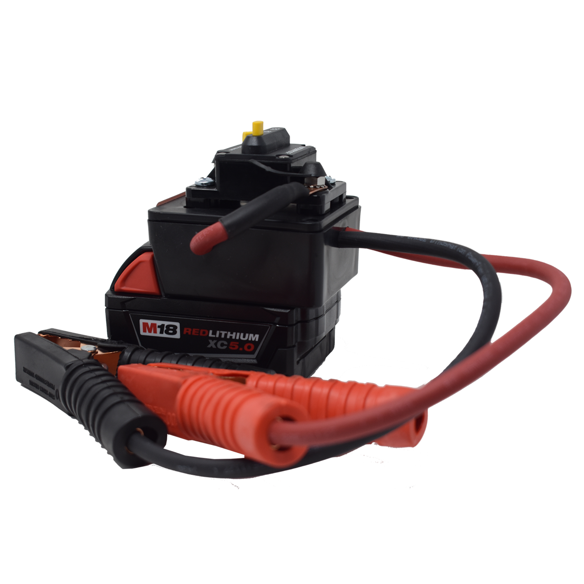

Most of the larger, and certainly the high output m18 batteries can deliver that kind of current easily. The problem you're going to have is finding a buck converter rated for that current. Realistically, you may not need to step the voltage down. The winch is probably capable of 14 and 1/2 or so volts from a car's alternator and under load, an 18 volt battery will sag a little. Granted, it's probably higher than 18 volts fresh off the charger.
If you do end up getting up buck converter, one of the little Power Wheels adapter versions on Amazon is probably not going to cut it. You may want to instead consider one intended to be used as a car jump starter. Much bigger cable and 60 amp fuse.

There certainly is the possibility of damaging one or both long term, but I don't know how probable it is, nor could I guess at the specific mechanism.
It sounds like you're married to the winch and the batteries because you already have both correct? It won't be long before people are in here telling you that a winch is not a hoist, and they they are not for lifting, but just in case they don't, I'll be the first to say it. Beyond that's, it's up to your discretion.
Here's that milwaukee jump starter I mentioned.

18v into a 12v motor, especially one that will be doing work will not be good for the motor. That's a 50% over voltage. It will not like that.
You will either need a very beefy buck converter or a just get a 12v rechargable lithium pack. An LiFePO4 12v battery should be light enough to do what you want, and be easily chargable.

Thanks for the info on the jump starter, I'm guessing it has a high amp buck converter built in if it takes 18v to 12v, I'll most likely get that and utilize it. I am not married to any one idea yet, I did not purchase or make anything because I have done that before and wasted a lot of time and money, and in all my posts I did make sure to say "hoist" not "winch" I'm very aware of the difference, I do not want a free moving clutch on the motor like a winch, I want something that has a locker if anything happends lifting a load, the one I had in mind is 100% a hoist.

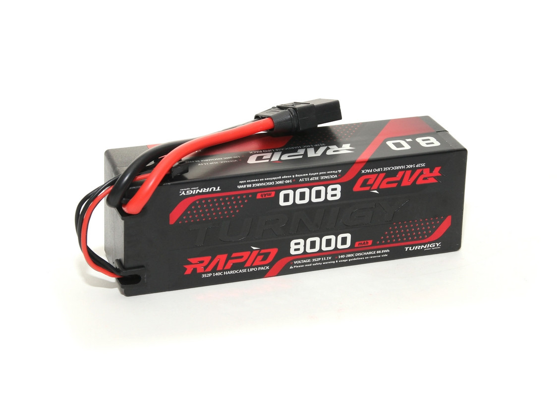

Modern battery packs (like a Li-ion or LiPo or LiFe pack) often have some sort of charge controller and load controller circuitry built in. Because those battery chemistry packs do NOT like electrical situations (either current/power IN or OUT) outside of certain design parameters. Else they literally go flash-bang-boom.
Old-school lead acid car starting battery can supply hundreds of amps for a short period of time. A deep cycle lead-acid battery can usually supply about 1/10 of the 'rated' amp-hours in amps without too much issue, but using that type and construction of battery for high amp uses damages and shortens the life of the battery. So a 100 amp-hour deep cycle battery can supply 10 amps for about 10 hours ok, but trying to pull 100 amps for 1 hour and the battery life is probably shortened a lot.
With a lithium-whatever battery, you have to check for the rating in both amp-hours AND max allowable amp draw that the load circuitry will allow before the circuit 'thinks' there is a short-circuit condition and it just stops ALL current flow until reset somehow.
And 50 amps pulled from any battery is not a trivial amount of current. For the battery and the wiring to deal with too.
An RC hobby battery like https://hobbyking.com/en_us/turnigy...-100c-lipo-battery-pack-w-xt90-connector.html is 6 A-hr rated.
I'll round things off a little here. If you pulled 60 amps from that you might get 6 minutes of use best-case. A hobby RC use-case might accept that short of a run time, a tool user might not like that short of a run time. And the battery will most likely get HOT and have to cool off before being recharged and then have to cool off before being used again.
It's all about trade offs. Size, weight, cost, life time, total available power, max power that can be withdrawn at a time, etc. TANSTAAFL.

There are still plenty of lipo options available. Even if you go 3s instead of 4 s, there are 8, 9, 10, and even 14 Amp Hour packs available that deliver ridiculous amps less than 2 pounds and for less than a new m18 battery.
