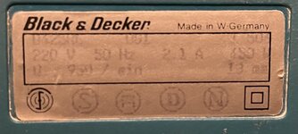

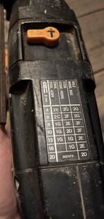

Hello everyone,
My knowledge about tools is limit (compared to you guys), especially when it comes to power tools.
I am in this lucky situation that I got gifted AEG SB 2E-20 and black & decker d425 re power tool by my neighbor since he was moving.
When I look at both power tools I see them both being a hammer drill - most used used to drill in concrete and concrete + steel mixture (I assume).
I have a couple of questions since I am considering giving one of them to another friend since I do not see the point in keeping both (if they have the same purpose, especially when I have friends there do not have any and could use one from time to time).
My question to you guys is:
1. Are these two tools the same?
2. What are the difference between them?
3. Which one is the when it comes to Power?
4. Which one is best when it comes to durability.
5. Which one should I keep?
Thank you so much in advance and for enlightening me with your knowledge.

The AEG tool will take wood, steel and stone drill bits (+ forstner bits etc.). So basically it can be used for drilling into everything except concrete and chiseling. The B+D drill has a "SDS Plus" chuck so it´s only good for drilling into concrete up to 20mm and chiseling (if so equipped). With more pics there might be more info :)
I did uploade som more pictures, maybe you have a better clue now 😅
The AEG feels like double as heavy as the B+D.
Thought if one could drill into steel and stone that it would be able to dill into concrete as well.
