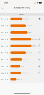

Like everything else on my to-do list, this one bumped down in priority.
I’ve been getting by with 3kW of floor heating. Even on days where the temps never got above zero F, I was able to maintain temp.
I guess this is what they mean when they say a properly designed system should keep temp on the coldest day of the year!
