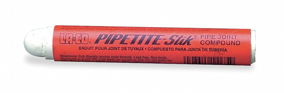

Charles (in GA)
Jan 11, 2006
12,489
50 mi south of Atlanta
LA-CO Industries Inc.
1201 Pratt Blvd.
Elk Grove, Ill 60007
PIPETITE-Stick Pipe Joint Compound
p/n 11175
Sold by Grainger. Best stuff I've ever run into. I have to heat it slightly (I use a propane torch, a candle would work) and you rub it into the male threads. Gasoline and oil proof. Non-toxic. good for 2000 psi liquids, and 350 psi gasses.
