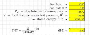

Edit: My calculation was a bit off.
A 30 gallon air tank has a volume of 4 cubic feet. At 120 psig (134.7 psia), the stored energy is 78,000 about 3,700,000 ft-lb or about 106,000 5,000,000 joules, the equivalent of 0.05 2.5 lb of TNT. But, no one has to prove that to the guy that was standing beside it.
Ive stood 30-40 feet away numerous times when 2.5lb dynamite charges have gone off ( avalanche control) and you can feel the blast pretty good, and that’s with the snow absorbing most of the blast. I couldn’t imagine standing next to that much force and not being dead. Dude is damn lucky if he was actually close enough to read the gauge.
