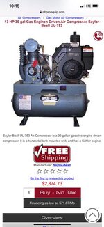

TonyJ
Sep 10, 2019
384
West Virginia
Or one like this that will likely out live you and will give plenty of air, easier to move around, and can be truck or trailer mounted for remote usage. And another plus is it’ll outlast the dewalt and all at the same time still saving a few hundred bucks between purchase prices
Tony
Tony
Tony, thank you for your reply. I am new to air compressors. What would I be losing by going down to a 30 gallon tank (instead of 80 gallon). Is it the higher CFM that makes up for the smaller tank size? Will I be able to run essentially any tool on the 30 gal. gas compressor, or will my options be limited to those that don't require much air consumption?

TonyJ
Sep 10, 2019
384
West Virginia
You can run just about any tool on a gas powered one. The difference your looking at is 30vs 80 gal. The compressor you listed the 7.5hp is going to be killer in amps to run with a generator and likely will kill a generator of the size you spec’ed in short order. Also your original idea included the use of a gas generator. That of course will put out fumes so it’ll have to set outside while running. The gas powered compressors how they keep up with the larger 80gal models is the gas motor doesn’t shut off when the tank is full it just slows down its rpm and the pump unloads until the tank is low on air and it kicks back in and fills it back up. The cycling of the 7.5hp is whats killing your idea and you would be better served with a gas powers model and set it outside ( fumes ) just like how you was going to have to do with the generator.
Tony

TonyJ
Sep 10, 2019
384
West Virginia
The 8 gal ones won’t have enough storage or cfm to get you and keep you going. Those are more for roofing jobs when using things like nailers and stuff or maybe pumping up a tire 2 miles out in the woods lol. Just for an insight for instance. The 30 gal ones are usually always the choice for service trucks around here like the trucks that goes out to the mines to work on a remote job. Those guys mainly use impact tools and impact tools can use allot of air but those 30 gal compressors get the job done. Also something else that can be done is you can always set the 30gal one up outside and get you a 60 or 80gal used tank and set the tank inside your shop and just plumb they two together and the 20cfm pump won’t have no issues keeping both tanks up and going

TonyJ
Sep 10, 2019
384
West Virginia
I absolutely LOVE your idea of linking up the 30 gallon gas compressor to a larger (60 gallon, or 80 gallon) down the road. Do they even sell tanks that big as stand alone? Will that not be too much strain on the engine?
I plan on using most automotive tools and body shop tools with my compressor, so will a 20cfm 30 gallon gas compressor suffice? Also, what are the limitations of the 30 gallon gas compressor? In other words, what will I for sure not be able to do?
The pump that is on the gas one that I posted earlier in the thread is a Saylor Beall 705 pump. That same pump is sold in many different configurations as in gas engine 30 gal, electric horizontal 60gal & 80gal and also vertical 60 & 80gal. So no it won’t have any problems with a two tank configuration. It will just run a little longer filling the tanks but also you will have more air storage between each pump cycle. Saylor Beall and Quincy pumps are well known as being top of the line compressors and most of the time they out live the people that buy them when treated right with maintenance. This one is 30 gal because of portability and that’s why most gas driven ones are 30gal and not larger.
Tony
Tony
Many thanks Tony! I noticed the compressor you listed mentions the cfm @ 175psi. Most stationary compressors mention cfm @ 90psi. Am I missing something?
