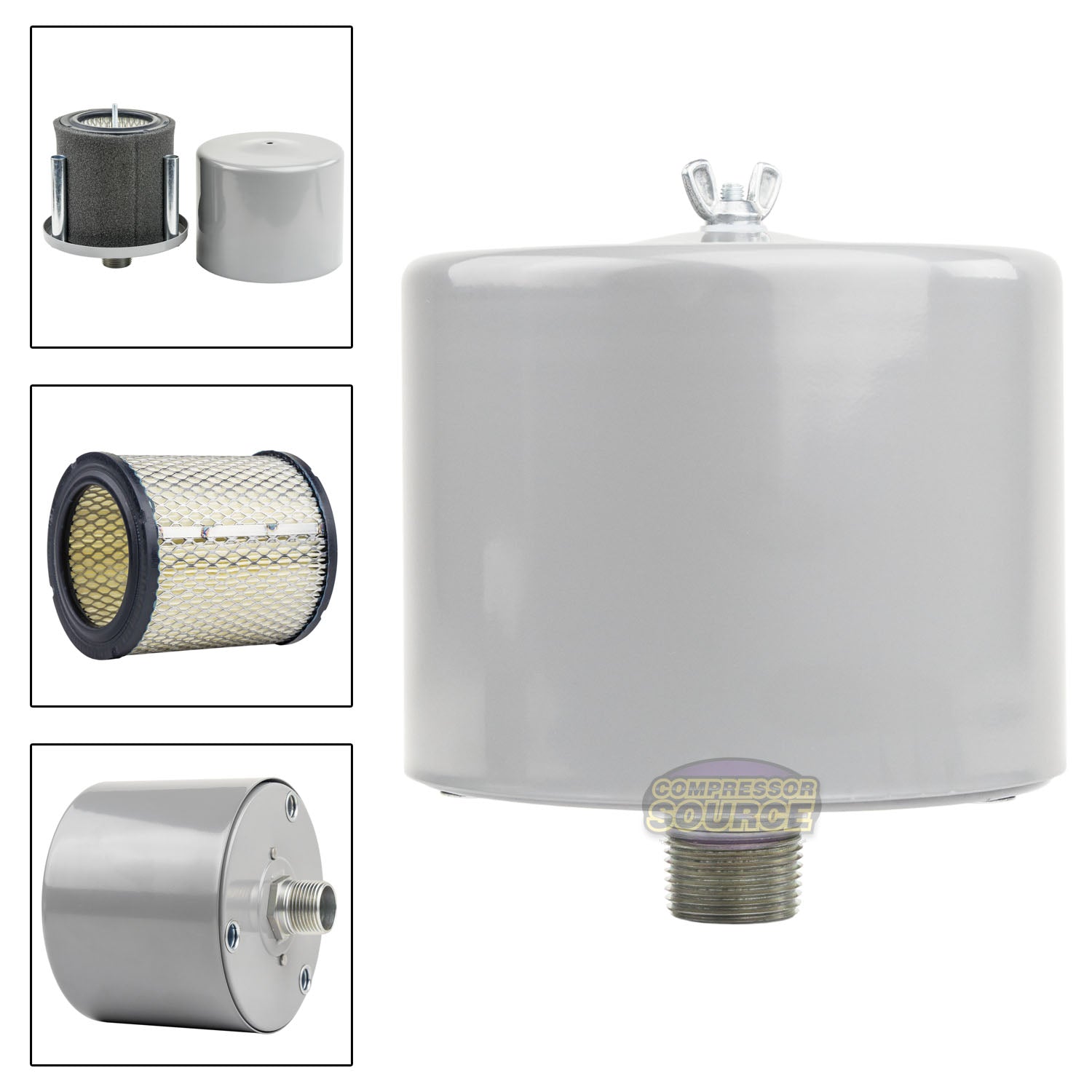

The old filter plugs in to a 1 1/4" smooth intake and fastens with a set screw.
Get a 1" size black pipe ******. The OD is 1.3" more or less. Cut one threaded end off and file it down to fit the opening. Then find a filter that will attach to 1"MPT.
Here's one with a 1"mpt, so you'd need a coupler.
