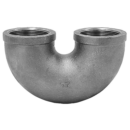

3/4 swivel 90 out of the tank to an 18" 3/4 hydraulic hose to a black iron tee (trap on the south end of the tee).
3/4 black iron trunk running 25-30' before the first drop / water separator and falling back to water trap near compressor.
Four 1/2 drops that swing up before dropping down. Traps with valves at the end of each drop. Regulator and filter on each drop. I'll also probably add a drop or two in the future for maybe an additional bench or an outside connection for spraying/sanding/grinding out back.

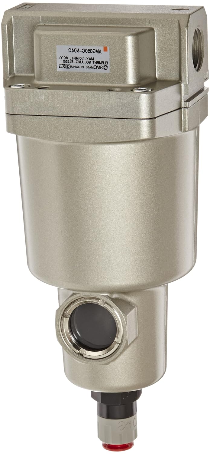

This is the water separator I'm looking at. Has good reviews (not many reviews on the 3/4 but the 1/2 has a lot). Would this be a good choice or is there something better in the same price range?

I question the need for Schedule 80 on the input side. Personally I'd go larger but make sure it can be decoupled. For example, you could use larger diameter PVC but put a flexible "boot" as on the throttle body of a car being isolated from the airbox/air filter. In my mind, no sense in making the pump work hard on the input side. Along those lines the unmuffled sound could also echo in the crawl space making it an undesirable choice. Some Roxul baffles in a "corn maze" type configuration should help out.
My airline plan which is a collection of parts and pipes includes a 1" cyclonic filter followed by a 1" coalescing filter before going to the header system. A rough and a fine separator if you will. The catalog data for the 1" coalescing filter indicates that it won't be a significant restriction with my volume.
Your drip leg can be built to store as much water as you want. Either by length or using bell reducers to open up to a large pipe for "storage" and then back down to the drain valve. I have seen industrial systems with a 2" drip leg fed by a 1/2" main line. Just depends on how often you want or need to blow it down...which may have to be determined by experimentation.
My other free advice is to either integrate a pipe union every so often or else space it out from the wall such that one can be "cut in" if ever needed in the future. Its common to get going on a black pipe run all assembled in series from one end to the other and then realize its time for an unexpected drop somewhere in the middle...

The original plan was to use 3/8 filters at each drop. The only thing I wanted to put on the 3/4 trunk was the water separator. I'm a little confused there but the water separator is essentially a coalescing filter? This is the one I was looking at...
SMC AMG450C-N06C Water Separator, N.C. Auto Drain, 2,200 L/min, 3/4" NPT
I can't find any photos of the inside of the unit or any details about how it separates but it's basically just a coalescing filter?

This would be ok with big tools that needed the demand of a 3/4 pipe but in this case the demand is 3/8 hose. I got one in 1/2 doesn't work right, is really too big and the air is just too slow with 1 tool at a time.
I had another system before with some water come down it, the smaller units did a nice job and collected it.

Cant beat that for 30$, would score that and I don't need it. I actually have one came with some stuff for 1/4 and don't even have it hooked up, got no use for 50 ft of 1/4, should post it.
Gotcha. Thanks. The air speed is something I "missed" when researching how to do this. I thought the point of use filtering/separating was to catch it closer to the tool. Didn't consider the air speed.
