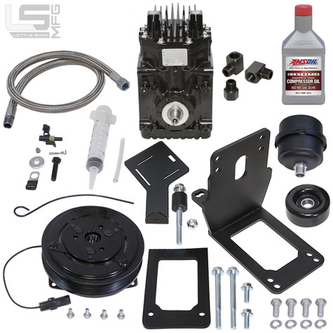

Would one of the kits offer on this site fit your truck?
The kits use a common automotive AC compressor. Seems like you might be able to make it work with a trip to the junk yard.
