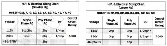

Get a Square-D replacement switch (can get on Amazon) - there are many options - this link shows some of the more common switches and the options:
http://www.hfwinc.com/uploads/specs/Square_D_Pressure_Switches.pdf
Thanks, that helps narrow it down.
They show models for smaller (1.5HP on single phase) and larger (2HP on single phase) HP motors. Table below. I have one of those old 20-gal 5HP horizontal tank compressors. It's certainly not a 5HP motor. Pic of motor label attached. Any idea if I should get a switch for "smaller" or "larger" HP motor?
Your motor is around 2HP so I would go with the bigger one.
Thanks. That's what I was thinking since the motor is 15A at 115V, so ~1.5kW, which is what the higher HP switch is rated for.
These are a bit more pricey and not as readily available as the lower HP version. Kinda running up how much I'm sinking into this old compressor.

I wouldn't worry about the HP claims. If the switch is rated for 15A, 120V you are fine. All of these are meant to switch a motor so just check the amperage.
Um, no. The big deal here is not running current, but starting current, which can be as high as eight times as much as the full-load current.
Plus, a motor is an inductive load, not a resistive one, so interrupting current to such a load can cause a large arc at the contacts, depending upon exactly where you are on the AC voltage waveform when the current is interrupted.
So for a motor, you can't just use the current - that's why electrical switching devices have separate ratings (typically in motor HP) besides the resistive load ratings listed on them.
Yes, you can get away with using an under-rated switching device - for awhile. But in this case, spending a few more dollars for the pressure switch with the larger contacts is money well spent and the correct thing to do.
Thanks for the explanation. I was wondering how an undersized switch would manifest problems. :beer:
I'm well aware of the issues associated with inrush current and back emf. Look back at what I was saying. These switches are designed to switch motors. A switch that is rated to switch a 15A, 120V compressor motor is fine. This isn't under rating. The 2hp switch is likely rated at 20A, 120V. Since this is a 15A motor pairing it with a 15A electric motor switch is fine.
Also, note that the motor has no HP rating. It's a compressor "special". A 15A compressor switch should be fine.

Do note that most pressure switches are rated for the same 15A as your motor. While your compressor might call itself 2hp, the motor plate has no rating so use the 15A as your guide.
