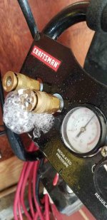

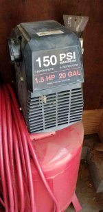

My quick connect couplers are leaking and I need to replace them. I'm going to look for good ones and not HF but I need tips on the proper way to replace them. Will tape work or is this a case for pipe dope???
The compressor is only used for tires and blowing clean small parts but has worked well for several years in my garage.
Any help will be greatly appreciated.

I use teflon tape, wrapped 2-3 times in the direction of the threads.
My current couplers and plugs are made by Stedlin. I like them ALOT. Quiet and easy to use. No leaks. Also very easy to insert under pressure.
I previously used Dixon (European) high flow couplers/plugs. One coupler failed and started to leak. They replaced it under warranty. Plugs were never an issue. Except they were REALLY hard to insert under pressure.

teflon tape is your friend. buy good quality replacements, Milton brand work well for me. the plugs don't matter as much, but the cheap couplings don't last .
I thought that Teflon tape would be the way to go but it's so easy to ask an informed group and get a knowledgeable answer and erase any doubts and worries.
Teflon tape it is and I will look into the suggested Milton couplers. My air compressor isn't a daily tool but it sure is handy when I need it.
Thanks for the quick replies.

I have started to use the thicker (pink) Teflon tape. 3 wraps on 1” or less 4 wraps on larger connections. Wrap it in the proper direction or it is pretty useless. Sometimes I even use pipe dope with the tape.

Contrarian that I am, I seldom use tape. Instead I use a white pipe dope that contains teflon. Much easier to apply for me.
seems like everytime I've tried tape it gets dropped and unrolled a dozen times.
But, I bet both worked equally well.

I use both together now. Light wrap with the tape then dope it up. When I used just tape, I did get the (very) occasional leaker. So now its both.
It's cheap so why not overkill a bit.

I just use Teflon tape. I also suggest either adding a ball shutoff valve or turning the regulator down to cut off stream leaks.

I now use Teflon paste unless I am out in the field or working in the dirt. Then I use the tape.

I've been using teflon tape on pipe threads for a long long time and I wrap the tape tightly in the same direction as the thread 2 to 3 turns and never have a leak unless the thread is defective.

Here's a list of the PTFE (teflon) colors from wikipedia.
The white tape in the plumbing aisle is typically pretty thin. The yellow tape is thicker and is pretty easy to find in the HVAC aisle. Makes sense to use it for compressed air.
White: used on NPT threads up to 3/8 inch
Yellow: used on NPT threads 1/2 inch to 2 inch, often labeled "gas tape"
Pink: used on NPT threads 1/2 inch to 2 inch, safe for potable water
Green: oil-free PTFE used on oxygen lines and some specific medical gasses
Gray: contains nickel, anti-seizing, anti-galling and anti-corrosion, used for stainless pipes
Copper: contains copper granules and is certified as a thread lubricant but not a sealer

It looks like the inside of the coupler is leaking. That appears to be a mobile unit, I've always put a ball valve between my coupler and the tank, but this was on stationary units. Heck my portable tank has a ball valve on it before the hose. (It also has a male end on the hose, the air chuck has a female on it, when I air it up, I just connect the hose ends together and open the valves on each tank.)
