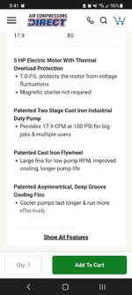

Sure a magnetic starter would be better, but on nearly all 5hp compressors with thermally protected motors you will not see them.
They come straight from the factory like this...Screenshot_20220503-085107_Chrome.jpgScreenshot_20220503-085059_Chrome.jpg

Well, ok..."apples & oranges".
"Specsmanship" strikes again. The motors in the pictures posted above may SAY 5HP, but those are *NOT* 5HP motors. Not even close.
The whole marketing thing about "Horsepower = determining torque, dividing by amps, multiplying by your locker number, raising to the square of your hat size, then dividing by you street address" runs rampant in many industries where the motor is integral to the final product. Those 2 compressors in the posting above this one are no way 5HP motors.
By contrast, the OP's photo is, indeed, a 5HP motor (though it shows 6HP definite purpose), and the current draw (26A @240V) confirms such. THAT motor most certainly needs a contactor. No question about it.

Baldor makes 5hp thermally protected motors that do not require magnetic starters...
It's not the motor that is the problem, but the pressure switch. Pull up just about any air compressor pressure switch and look at the ratings for it. Most are only rated to switch 3 horsepower and under. Square D makes some that will, and I'm sure others do too, BUT you have to start running 460VAC to get to a 5 hp rating.
5HP @ 240V (single phase) draws about 28A with an inrush of about 150A (assuming not starting against head pressure). Without a contactor, what switch do they suggest using to turn such a motor on? Bottom line, the contacts of whatever switch is selected needs to handle that current, and I can't think of ANYTHING, besides a contactor, that can do such.
What am I missing?
EDIT:: wait...I think I'm "seeing" it. A "Motor Starter" is a contactor + a thermal overload. Is Baldor saying that, "...because we have internal thermal protection, then a motor starter (i.e. "overload protection on a contactor") isn't needed..."? Is that it? You could do without the overload, but you'd certainly still need the contactor.
