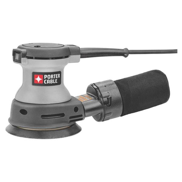

High CFM/high duty cycle air tools can often be replaced with electric or lithium.
For example this little guy's huge CFM needs will run a 5 HP/2 stage/80 gallon compressor almost continuously:
So why not use this instead.

I totally agree with everything you said. I prefer lithium ion and corded tools over air personally. I just need the occasional bust of hard air to clear out fine dirt n whatever may be under the car seats.
