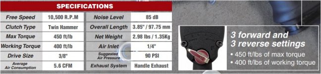

Astro 1828 will do you .
compact and light, pretty powerful, good throttle control and power setting lever .
Well liked impacts at good value and good company support .

Good power adjustment, using the power adjustment and learn the power ranges of it quick before you fubar things .
We all have the odd accident with impacts but if you wrecking lot of fasteners it purely operator issue

Air impacts, especially the smaller ones usually have power settings. I don't see my stubby air cat breaking anything if it is on the first or second power setting.
