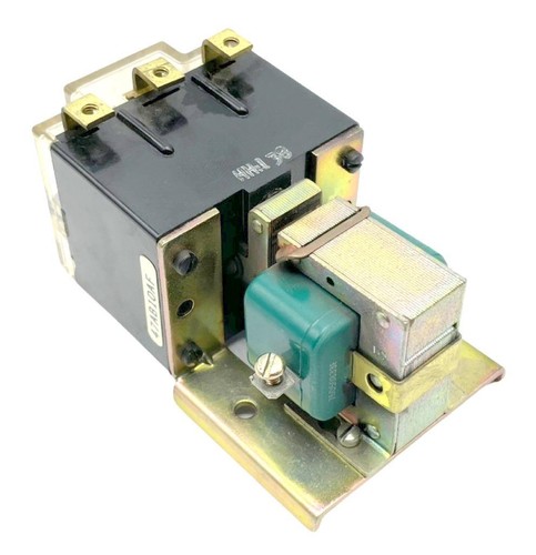

A Furnas alternating relay might fit the bill, they are rather spendy but this one on eBay is a little cheaper. Furnas Electric was bought by Siemens, & they sold parts of the product line to Hubbell, including this relay.
More links here.
