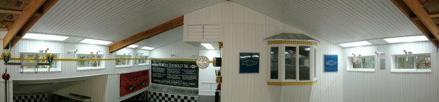

When the textured finish of our drywall patio ceiling started to flake off, I used vinyl soffit material to cover it up. Because it is so lightweight, I was able to screw it directly to the existing drywall. It worked so well in my workshop, I figured why not use it on the patio too.
Follow this link to see my collective information on using the vinyl soffit material:
ASYLUM Thread Reply#1014
Here's the way the shop looks with it:
