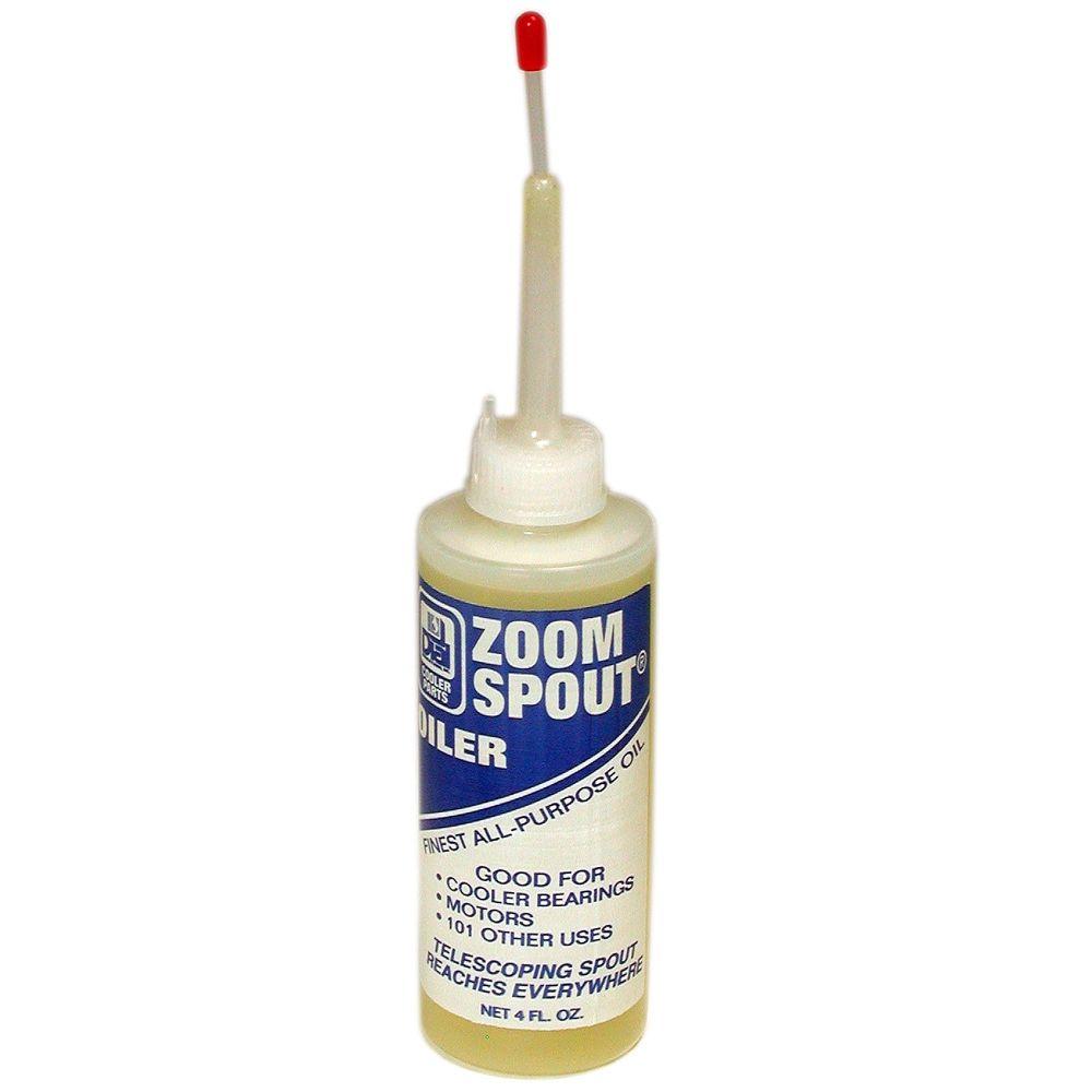

I use white lithium spray grease for things like that. It is a light grease. Or you can get an oiler like appliance people use that has a long telescoping spout. This one is sold at Home Depot.
