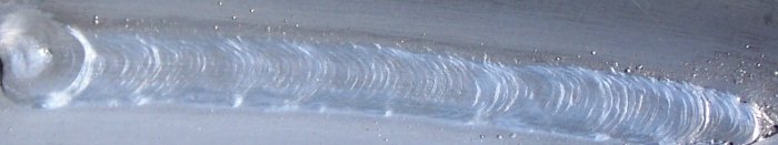

I'm just getting into Aluminum work. This was 5052 welded to 6061 with 5356 wire. Powermig 300 using pulse on pulse mode, push gun only. Get the settings right, keep the angle and stickout perfect and this machine does all the work. Get the angle a little off and things go downhill in a hurry. Still working on getting it dialed in, in this pic I think I need a little hotter start procedure and a different technique at the end to avoid getting that crater. A push-pull gun is high on my wish list but for now I am using the u-groove feed rollers and keeping the gun straight and getting by. The soot that has been mentioned is interesting. As soon as I start to weld I can see if I have a clean strip on either side of the bead. If it's there the weld will be okay, if not then something is not right.
