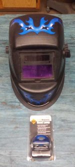

I'm almost 60 and have the same diminishing vision. I put a 2.0 cheater lens in and added a bright, inexpensive LED light to my HF helmet. By using screws with a stack of washers underneath the mount, I can adjust where it points. I leave my glasses off when using the cheater lens. The light is a few dollars from HF and really helps by shining a bright light at the work. This combination really made a difference for me.
