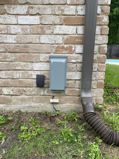

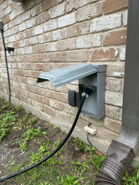

I got my garage panel upgraded today as well as getting the interlock installed. 30a breaker in there now, but the inlet was out of stock so it goes nowhere
I might grab the 50a, seems to make sense
This panel has feed through lugs and feeds my house, and the 60a breaker goes to the garage sub panel. It will be upgraded to 125a when the breaker arrives, all out of stock

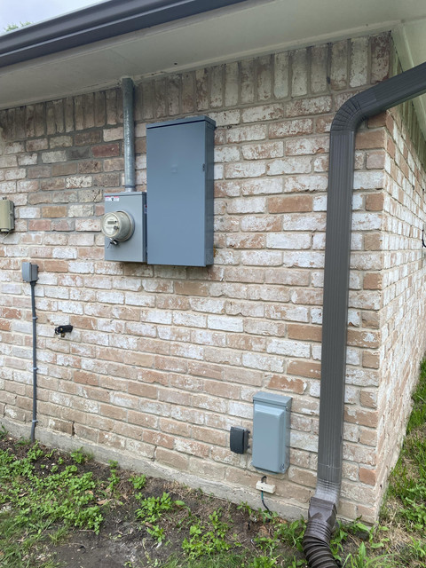

The 27kw Generator comes off the transfer switch on the line side, before the main breaker on the panel
But, if I want to connect a gasoline generator, I can now use it with the inlet
