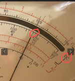

I am learning to use my Triplet analog meter and not doing well at it. I am testing a 9v battery to measure voltage. So if I read the scale correctly it is saying 12v (I have set the main switch/scale at 12v DCv).
If I use my digital craftsman then it says 9v. So what am doing wrong here?

Got it. Misunderstood the instructions. Didn’t realize there were two other lines under that lower one. Thank you,

Looks like a hair over 9.5V
There's a parallax issue that we can see in the mirror on the scale. To my eye, I believe that if the camera were placed so that the needle would obscure it's reflection (as it is supposed to be read), the reading would be OVER 9.6VDC, even though it's just under the line for 9.6 right now. Whether it would fall closer to 9.6 or 9.7 is hard to say.

For those not old enough to have used these meters 50 or 60 years ago, that's a parallax-correcting scale.
1000002965-png.2466960
See the mirror strip just above the red circle where you can see a reflection of the needle? The trick is to line the needle and the reflection up by moving your head or the meter. Then you can be sure you're looking at the needle and scale head-on, eliminating parallax.

Is that meter reading "open circuit" (no-load) voltage, or is it providing some calibrated load to the battery?
Testing lil' batteries (or cells) like that without a load on them is kinda useless. A battery (or cell) near the end of it's life can measure OK with no load, but fall flat on it's little keister with even a small load.
