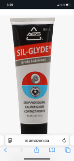

Am I using the right grease for brake slider pins?
Burt Shaver
Dec 7, 2023
1,282
Iroquois, Ontario Canada
IMG_3842.jpegIMG_3843.jpegAm I using the right grease for these slider pins? I’m just putting the summer tires in my daughter’s 09 Hyundai and I like to service the brakes at this time, make sure the sliders are sliding easy and the pads moving freely. Anyways I found this slider seized, figured I would just take it apart clean it and re grease it as usual but I found the rubber piece at the end of the pin won’t stay in place. Just wondering if this is the correct grease or if I’m using the wrong stuff causing the rubber parts to swell? This is what was recommended to me at Napa and it does does say Silicone ceramic brake lubricant so I’m thinking silicone won’t swell rubber? But not sure. Thanks for any replies

What you are probably experiencing is air trapped in the boot that the pin sits in.
wipe off some of that grease/lube where the seal seats on the groove.
The grease in there will form a good seal making air escape harder.
I have found that a few turns and several back-and-forth motions will get it to seat on the lip of the caliper bolt.
The lube (as far as I know will not hurt it) but the best advice is to make sure mating surfaces are clean of corrosion and a light application of lube.
Orange lube for me!

...Just wondering if this is the correct grease or if I’m using the wrong stuff causing the rubber parts to swell? This is what was recommended to me at Napa and it does does say Silicone ceramic brake lubricant so I’m thinking silicone won’t swell rubber? But not sure. Thanks for any replies
I made the same mistake a long time back when using the Permatex green ultra silicone garbage, and had the same swelling. Syl-glide has never failed for me.

Yes, the orange silicone ceramic stuff from Permatex is what I use and it does not swell the rubber. It is also good for metal to metal contact points so you can use it to do the whole brake job. Anti-sieze is good for metal to metal but not good on the rubber parts due to swelling. Historically, Sil-Glyde has been the go to lubricant for rubber parts/pins.

Your experiencing rubber swelling. Ive had it happen with Permetex green / purple brake lube too. Now I use what Oem product is specced .
We have a lot of Toyotas, so Toyota Rubber Lube 0888701206 is used a lot. Most of the shops use KleenFlo's(?) silicone paste

Sta-Lube Caliper Grease if the factory/OEM orange grease is not available.
This is what you want.

Yep, sil-gldye for the win, but the ceramic grease probably isn’t what caused the problem.
Google says.
Rubber brake parts swell when exposed to engine oil, ATF (automatic transmission fluid), or other petroleum-based fluids, which can compromise the brake system's integrity and lead to potential failure

The only thing I ever found at the regular stores that really works on slide pins is sil-glide.
Toyota calls for “lithium soap based glycol grease” which people see to call “pink brake grease”. Which you can get in a toothpaste like tube at the dealer parts counter for half of what it sells for on Amazon. I’ve used both and this works just as well as sil-glide.
