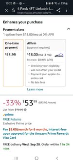

Is anyone usong these lights from amazon? Looking to replace the lights in my 38x58 with these. Almost aeems too cheap to be good but the reviews all look great from what ive seen.
hoping someone on here has first hamd experience with them
Screenshot_20220922-222537_Samsung Internet.jpgScreenshot_20220922-222601_Samsung Internet.jpg

It looks like they have decent reviews. I used the Koda ones bought from Costco, so not the same.
However in terms of lighting my garage is 38 wide and 32 long, and with 3 large doors I arranged my lighting into bays with a row of 3 lights on each side of each bay, for a total of 18 lights. For my square footage, it's very bright and I will only be adding a couple more above work areas just for a little added light, but I've been working in it over a year with these lights and it has been great. Much better than the 6 incandescent bulbs before that hardly lit up anything.

Lots of those offshore lights available in quite a few different formats.
A couple things to consider. They're likely not UL listed. At best CE, and CE may means China Export in that case. They're probably not as bright as the specs say. And they'll probably have the occasional LED burn out in short order - but that probably won't be that noticeable.
If none of that bothers you, then they're probably a pretty good deal. I bought a set of 4ft linkable ones off Amazon for my shop and they work pretty good. I still think I need more though.

I bought a 4-pack three months ago and everything’s good. $48 total to my door. I have 8 seven year old units from Costco, and one started to flicker recently. Don’t know the failure mode to cause that. Im down to 5 25 year old fluorescent fixtures, that I throw away as soon as they have a problem. I have a lifetime supply of CRI 90 bulbs for those.

I am not a fan if that kind of fixture. The issue is if the LED driver electronics goes out you have to replace the fixture. And unless you bought a lot if spares, the new fixture us unlikely to match the old ones. So instead I prefer the replaceable tube type. The fixture should last the life of the house and I can replace tubes as needed.

They're ETL listed. ETL is a National Recognized (by the US) Testing Lab
UL isn't the only game in town
Then they're one step ahead of a lot of the other off shore lights available. There's tons that only have CE
