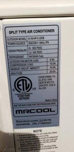

My 36k says it runs on about 15a but needs a 40a breaker. Photo below from my manual on their various size machines.dc86d1ea760a3c96717d92f8f4e89a14.jpg

Alright, this is right off my brand new mrcool advantage 18k minisplit. Looks like 10.5 amps plus what the indoor fan unit draws, which I haven't unboxed yet. I will post it as soon as I do. Just figure 15 amps for your load calculations and you will be alright

I posted the information right off the unit in post #25. How much more info do you need. It gives the amp draw under full load. These inverter units run at variable speeds, which will give you different amp draws at different loads. They do not run at a constant amperage. Size you service with the full load off the plate. Why would you want to run your service close up to its full capacity anyway. You always leave room for expansion. Run the 125 amps and be done with it. The larger wire now is way cheaper than changing it later
