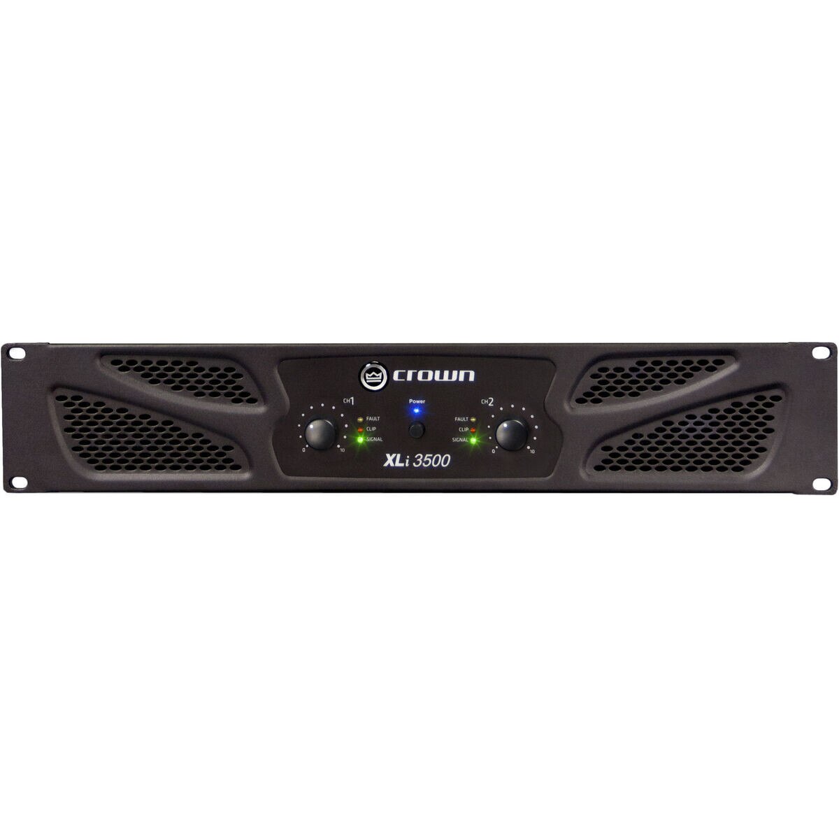

looking at amps i see mostly 2 channel so i would need 2 amps to run all 4? can someone explain the connections on the back of the speaker and the cabling required ?
thanks
ltusler
Dec 29, 2013
207
Greenfield, MN
The speakers are pretty efficient, so you don't need tons of power, but more is better than less. They are a 2 wire 8 ohm connection unless you biamp then and use a speaker controller DSP which is an advanced subject.
The round connector in the middle is called a Speakon connector. It is a 2 or 4 wire locking connector. You can get them at Parts Express, Most pro amps will have the same.
You will need 4 channels of power to drive them all. Pro amps aren't really "stereo" just called 2 channel. They can run in 2 channel or bridge mode.
You will need separate sources to drive pro amps.
You can also drive them with a traditional receiver. Just make sure there is enough power to drive both the A and B outputs without clipping at high volumes and you're all set,

i really appreciate the information, is there any brand amp i should be looking at? QSC was mentioned above. looks like most in that style are rack mount which isn't a big deal i can find that cheap enough or probably free.
ltusler
Dec 29, 2013
207
Greenfield, MN
QSC is what I use Crown and Carvin are also good, I would stay away from the low end brands. I just put stick on feet on the bottom and stack them. They flow air horizontally. I use them in my main 2 channel bi amped system with the fans disconnected. They never even get hot.

So looking at the specs of the soeaker they are 600 watt 8ohm so If I wanted to power 2 of them I would need a 2 channel 600 watt per channel at 8ohm?

I'd look for a used stereo receiver from Yamaha, denon, Marantz, Sony, etc.
Most of the time, you'll probably be using about 20 watts. A little goes a long way
Uh, no. If he's going to crank those speakers, he'll need a lot more power than the amps you mentioned. Underpowered amps damage speakers a lot more than overpowered amps. The hi-frequency drivers won't need much power, but the woofers will.
20 watts, are you kidding me? 200 watt RMS rated amps were fine for my home speakers, but I've always needed (600w-1200w) commercial amps to drive all of the pro audio speakers that I've owned over the years in order for them to sound proper.
Yeah, nah. It's best to have the amp pushing more or less twice the watts the speakers can handle.
Reason being that when the amp starts to saturate, and this is not always obvious to the ears, the amp sends square waves to the speakers, DC current, and that will kill a speaker fast.
When it's the other way around, where the speakers are saturating/distorting before the amp, it's very obvious and annoying, and it takes a bit longer before the speakers start to deteriorate.

there is a guy locally selling a couple crown XLS1000 amps looks like they are 215w at 8owm. ill have to explore Ebay and see what i can find

You'll need a preamp as well. That's an advantage of a receiver.
You can also get a receiver and if you want more power, add on amps later.

With 600W of power capacity for the speakers, he'd be good with a 1000-1200W per channel power amp so as not to blow the speakers.
It's a logarithmic scale. Twice as loud as 25W is about 625W (25 square or 25 times 25).
