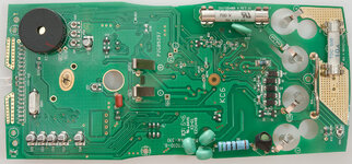

Hi all, about 8 years ago I bought an Amprobe AM-510 on the recommendation of this board. IIRC it was because it was a good value being a fluke subsidiary, and containing a lot of fluke parts. But now when you turn the dial, it makes a high pitched electrical squealing, and some electrical creaking noises. And typically the screen just stops displaying anything as you're trying to use it. So I'm guessing it's done for. I made sure the rechargeable 9v battery has a full charge.
So what's a good mulitmeter to replace it, that won't break the bank? Seems like everybody and their dog makes one. Is there anything wrong with the Klein MM400? It's only $80 and people who review it seem to like it well enough. Maybe it's not up to amprobe or fluke standards, but maybe it will do the job on automotive, just fine.

Open it up and look for a blown out capacitor. It may be a cheap and easy fix. Have you tried a non-rechargeable standard 9V battery?

Following up on what rlitman said, it looks like there are 6 electrolytics on the top of the board, and two on the bottom. One is marked 4.7uF/35V, the others are all 10 uF/16V.
These SMD electrolytic capacitors can fail with a tell-tale "fishy" smell from the leaked electrolyte. Might be worth a sniff.
Some great teardown photos are available at Henrik Jensen's review site.

Doesn't smell fishy, and there doesn't seem to be any obvious burnt spots. There's a little weirdness around the flashlight button on the board, in the form of some very small, hazy white staining. But I never use the flashlight button, and it doesn't seem like that would cause these kinds of problems.
Maybe there's someone out there who does repairs on them. Then again maybe it's not worth the expense, and I'm better off just buying a new one.
I'm not familiar with that type of fuse, but I did note that mine don't seem to have any writing on them. They're just white. At first you might think that means they're blown, but the meter does still try to work for a minute before the screen just stops displaying anything.
So that would lead you to believe the fuses must not be blown, otherwise it wouldn't work at all.

The fuses in meters are for protection when reading current. Even if blown they would not stop the meter from powering up or entering any of the functions.
If they were blown all that would happen is the meter wouldn't read current when attempting use that function.

Those 6 "electrolytic" capacitors look like aluminum/polymer capacitors and lack the cross slits the electrolytics have for venting purposes.

I’m really curious what happens if you try a fresh new alkaline 9V battery. DMM’s that take a 9V are very sensitive to battery voltage. Sometimes acting funny even before the low battery indicator comes on.
Put a new energizer 9v in there, same result. Guess the problem wasn't the battery. I had forgotten what I paid for the meter, but as one member mentioned it's not worth saving, it was $50 and it lasted about 7 years. It's in the garbage.
Well, ****. I was hoping that would square you away. Oh well it was worth a shot.
