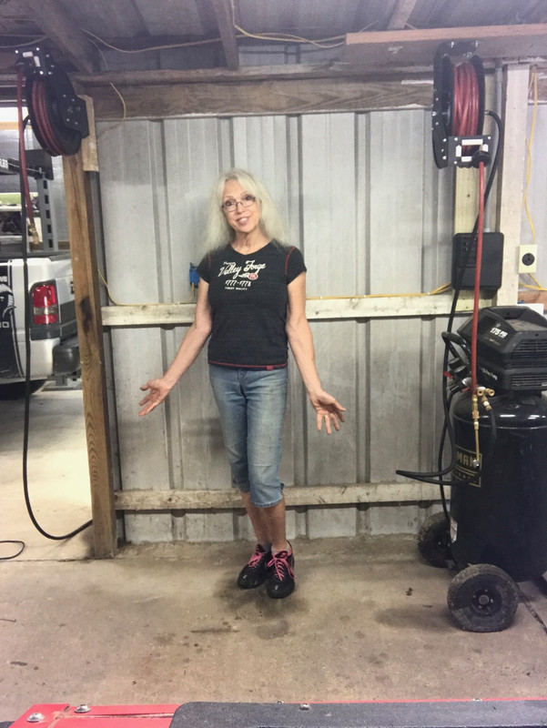

Hi, it's been a while since I've posted, but I've been looking at compressors for my newest location. My old sears compressor just isn't working very well especially for occasional cabinet blasting and especially with a HVLP spray gun. I'm perplexed on new compressors in the 5hp/60-80 gallon size. Reviews are like on Amazon, good and bad on everyone I look at. The new ones are so pretty, but have some issues, so I thought old might be better?:headscrat
So, started looking at older compressors and one popped up on CL. However, it's 3 phase! the man say it's a good compressor(yada yada),but it's 3 phase(I said that:wtf:). So what can be done if anything?? Can one switch out a 3 phase motor and put a single phase motor, or would that be terribly costly?
dne' ;)
https://houston.craigslist.org/tls/d/cypress-5-hp-air-compressor/6898830813.html
also found this in Dallas:
https://dallas.craigslist.org/dal/tls/d/kaufman-2-champion-air-compressor-5-hp/6885732580.html

Thanks Tool Tyrant and Dr Clyde;) I just spoke with the seller of the compressors in question. He says for my purposes the 60 gallon would be perfect. He says even the "radiator" cooler on the larger tank, doesn't work as well as most would think they do. He says yes, the condense but the condensation goes right into the tank. Also the pumps on both are the same output cfm wise. That being said, I'd probably be better off with the 60 gallon. I'm silly excited about either one and not having to deal with today's NEW compressors. Plus he said parts are readily available and all he does is work on compressors.
So, if all goes well, I'll have one of them here Saturday around noon!;) Getting it off my trailer will be no problem, however moving to an ideal spot may prove interesting. I think my neighbor has a front end loader on his tractor, but read somewhere for safety, just to remove the pump/motor?

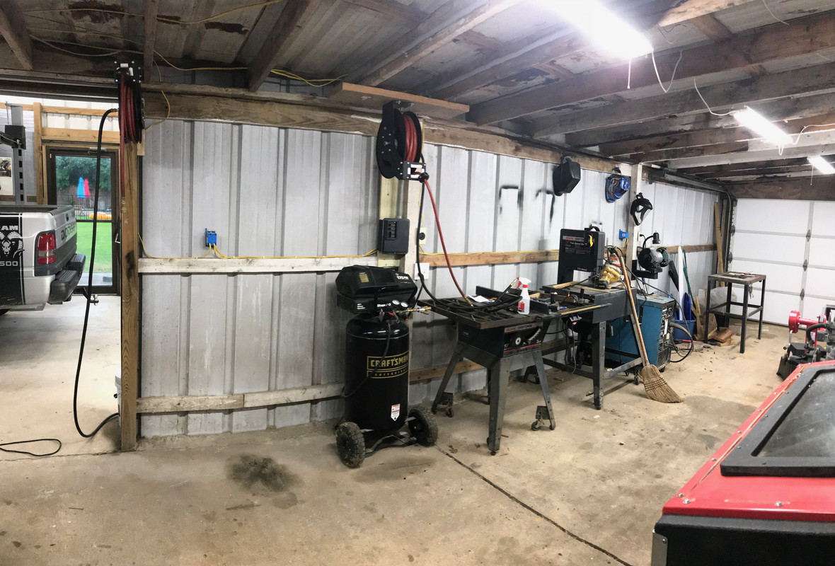

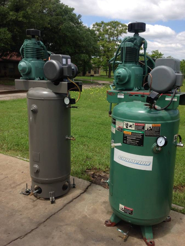

I'm still partial to the larger compressor, it just looks awesome! Yeah yeah, size doesn't matter:lol_hitti, but it just looks 'commercialish'.
This looks like the perfect place for one of em.
D
Denee007
Oct 21, 2010
266
Cypress, Tx
The 80 gallon just looks impressive, the 60 gallon~ the way it bolts/attaches to the floor looks~ weird. The larger one is 1275, 100 more than the 60 gallon.
dr_clyde
Jan 7, 2009
6,431
Holland, MI
Yeah, for only $100 more I’d get the bigger one too.
They both will be more compressor than you need I suspect.

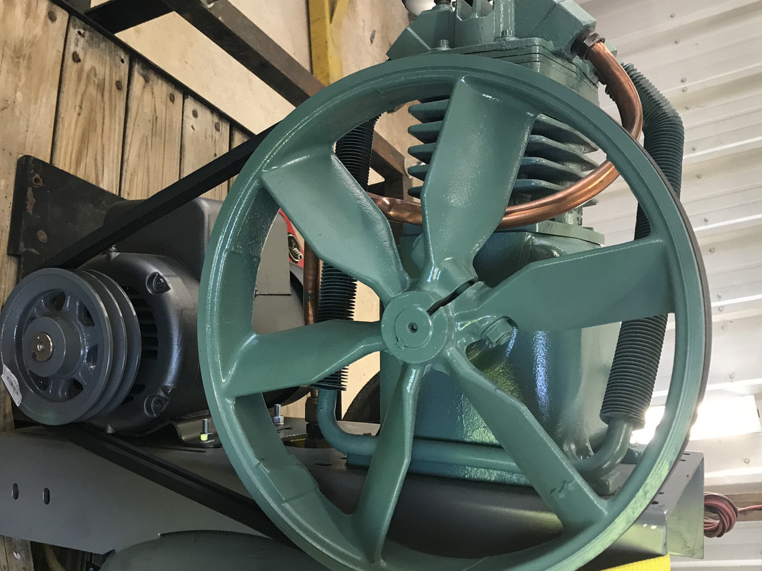

Hi! Made it back with the 60gal compressor, the 80gal was sold already:( but I'm very pleased with the 60gal:bounce::). Someone had called and ready to come out to get the 60g but he said it was sold(to me of course). I hadn't said that I wanted the 80,but even he can't take the word until money is in hand. The seller(Greg) was incredible:thumbup:, I stayed for a bit and had a cup of coffee discussing compressors and even discussed physical therapy for his back and other ailments, but it was like talking to a good friend:thumbup:
Greg did plug it in and I was delightfully pleased how quickly it pumped up and especially how quiet it is! It turns at 1750 rpm. He loaded it for me and helped me make sure it was secure for its journey back to Cypress, Tx.

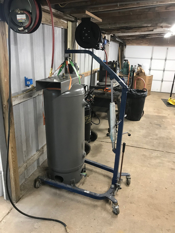

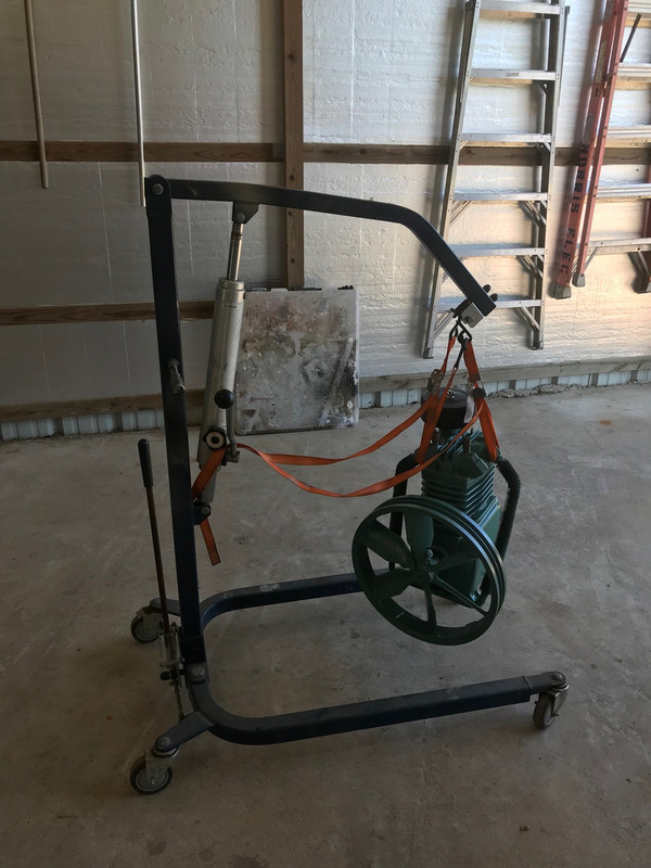

At home, I had a difficult time getting the compressor upright so I removed the heavy pump with my gantry crane to lighten the top end. Then used my gantry crane to stand it upright, lifted the tank/motor, then rolled the trailer out from underneath it.
I used my Little Mule (patient lift) to remove motor, they're both pretty darned heavy!
Since I have it apart, I plan to go ahead and paint the tank to match the pump in original Champion green, Gregg gave me the paint info., so I can take care of that next week some time.
So, the story isn't over as I haven't put it in service, but he stands behind his work and is there if I need help or advice. I'm pleased to have met him.
Thanks everyone~ I'll keep updating this as I go along!;)

Take your time setting it up. Be sure to use a straightedge across the pump pulley to motor pulley to verify the belts are inline. Be sure the drive belts are properly adjusted.
BTW, it's the motor that runs @ 1750 RPM, the pump turns quite a bit slower than that. To get the pump RPM, measure both the drive (motor) pulley diameter and the driven (pump) pulley diameter , next divide the drive pulley diameter by the driven pulley diameter, lastly, multiply the motor RPM by the quotient and your answer is the pump RPM. :thumbup:

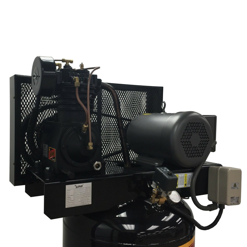

Just looking at compressors, most just have the 1/2" copper tube going directly into the tank, a few show a finned tube which could be nice if I could find one. Can't find those "extruded finned tubes" anywhere. However, I was thinking to just go ahead and replace my pump to tank copper tube with a long piece, perhaps with a coil or two, a loop. My copper piece looks a little flattened, not bad, but could increase resistance thus heat? lol Too much physics here.
me of course;)
strutaeng
Dec 12, 2011
2,261
Dallas, TX
This is one that you posted is the one that I bought for mine also:
https://www.ebay.com/itm/CQP14773C-...COOLER-3-4-TUBE-R30B-R30D-PL30A-/292047470365
Yours is a 2-stage, with that finned tube going from 1st stage to 2nd stage. It's called an "intercoolder."
Mine is a 1 stage with a little 30 gallon tank and that aftercooler. I have done body spray paint and have yet to have any problems with moisture. My compressor lives outside under a tarp, LOL.
I also have a one of these double air filter gadgets at the end of a 1/2x50' hose, but it has never had any moisture in it. Now, I do get water in the tank, but just drain it often.

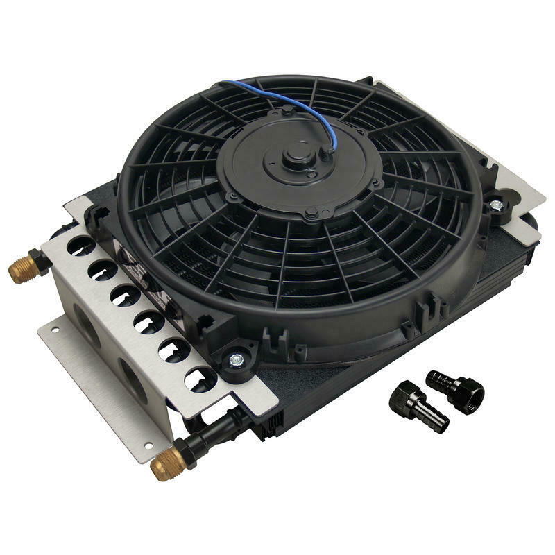

I was looking on ebay(where else) at stuff, and this seems interesting, but can't tell how large or small the tubes are. I wrote the seller, but don't expect to hear back. I could put a thin radiator fan 12v to 110v, just thinking out loud;)
https://www.ebay.com/itm/263280347390?ViewItem=&item=263280347390
This particular compressor has the finned tubing, couldn't find anything like that:(

The ebay seller did write back! "This item has a -8AN inlet and outlet, which is the equivalent to 1/2" in AN." I don't know how that translates into the pipe fitting on my compressor.
And this one being the lesser of tubes, a fan could be mounted on it as well.
https://www.ebay.com/itm/Derale-Oil...m=282707836633&_trksid=p2046732.c100040.m2060
This one is 149.oo free s/h

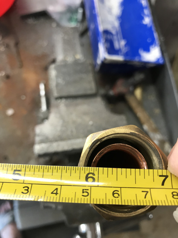

5/8 line!
I got to thinking about the line pump/tank, I thought it was 1/2" but looks to be 5/8", which is good I suppose, but erases my last two posts of ideas.:headscrat
