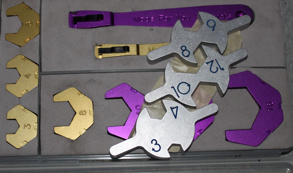

I use the ones below made by Made for You Products.. The head can be rotated on the handle into three different positions. They are awesome and not sure if they can be found anymore. The others are finger ones.
