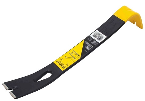

Used a small hand-axe (where it was thick) and a Wonderbar, what a great tool. Also a rubber hammer.
Don't see any pics showing the level you have, but that's what I'd do, plus I'd turn off the heat until late late Spring once this threat is gone.
