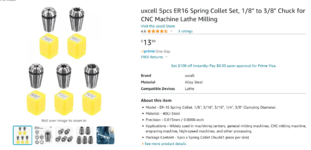

I had a bit of a challenge even finding an adapter like this, which I found surprising. Thought it would be pretty common. Adapts a standard 5/8" threaded angle grinder shank to a 1/4" clamping collet. Can anyone recommend one? If not, I'll probably try this one from Amazon.
This is the adapter in your link; it is an ER-16 collet system with two collets: 1/4" and 1/2". "
If you do purchase that adapter, recommend you get this 5-piece ER-16 collet set that includes 1/8" collet to run Dremel tool accessories:
