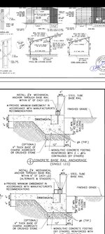

Carolina Carports told you to do this? I'm pouring concrete this week. They told me 8" wider than the dimensions of the building (4" in each direction).
They told me to make the slab the same size as the building so the sidewalls hang down over the bottom frame and a little over the concrete. That's what I did. They're actually installing my building as we speak. My concrete extends past the front wall as there's a 20 foot porch on it.
That's asinine IMO. All it does is make it easier for them to install so you can have a lifetime of water penetration issues later on. I guess they really are selling a "carport" where it doesn't need to be watertight.
MistrGoodwrench
May 22, 2012
62
Ocean Springs, MS
That's what I expected but they confirmed that it needed a 4" apron. Makes no sense to me.
What they told you doesn't sound right to me so I asked my installer and he said it definitely should be the same size so the sidewalls can extend past the concrete. Mine is going to extend about 2 inches and that makes perfect sense.
I've asked the parent company for clarification. I see no way a 4" offset will allow the metal to extend past the concrete.

They did tell me to do this, so it's what I did and was a huge mistake. I have 6" of slab around the entire building. I should have questioned this more. I think they tell you to do this so the "installers" dont blow out concrete edges with their anchors. Man I wish I could do my building over again!
EDIT: I was present when it was installed. I layed a thick bead of urethane sealant (Vulkem brand from Lowes) under the base plate which really helped prevent water intrusion, but didnt completely stop it in some spots. I highly recommend anyone getting one of these installed to do the same. I keep forgetting to post pics.

Well, I got an answer, sort of. It isn't called out on the plans but they sent this pic of how it's supposed to be installed with a 3/4" step built along the perimeter of the slab when it's poured.
That certainly makes more sense to step the slab down but why not just make it the same size. I talked with my installer again today about this and he said absolutely make it the same size unless there's a reason not to.
