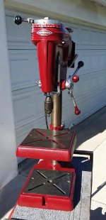

Here is a benchtop Craftsman 100 Drill Press I picked up with a Vari-SLO attachment. :)
I'm working on the restoration of this fine machine now and will post pics as I work through it.

I still have the head band and a few minor things to finish up.
But here it is. I struggled a bit with deciding on a color, but this burgandy red from Lowes turned out ok I think.
I don't plan to use the motor on it here, but I had to test it out with something while I rebuild the other motor. Veri-Slo works just as advertised.
I replaced bearings in everything but the vari-slo.

Looks good! If that was #5, did you flip any? How many do you still have? Are you going to restore the cross-slide vise too?
I think the DP needs to match Big Blue. :thumbup:
I haven't flipped any yet. I'm a handle shy of a full drill press, which isn't much. (that sounds like a garage journal insult). I have 3 total in parts, but a couple of them aren't very usable for full restoration.
I think I am going to do one more restoration at least, and see what I can get for a fully reconditioned DP. Otherwise, I'll start parting out what I have.
That said, I don't know if I can ever resist a good 100/150 deal on CL. These things are too cool. :D
I am going to try and get that McElvy motor speed controller up and running for this one. It would have 5 belts then total.
I am also going to cut down one of my longer pipes so I can add the table lift. The column on this one is about 2 inches too short.
Then it will be the ultimate steampunk machine.
I am still debating the vise, whether to sell or keep, but I will restore it.

Any thoughts on cleaning up aluminum? I'm afraid something will crack taking it apart.
torqueman2002
Jun 3, 2009
6,155
SE Michigan
Is it possible that those aluminum parts are really cast pot-metal? They kinda resemble each other. Aluminum or pot-metal, I would use a solvent with tooth brush and fine steel wool... no wire brush or wire wheel. If you're concerned about taking it apart, don't. Clean it up as best you can assembled.
I recall a post -- long ago, in another galaxy far far away, .... someone from the Dark Side cautioning to change speeds on a Vari-Slo ONLY when the DP is ON.
If the lever is moved when the DP is OFF, the pot-metal parts won't survive.

Brock, looks good. One suggestion, purchase a cogged belt 3 inches shorter than the one you are using from motor to the next pulley. It will being the motor approx 1.5 inches closer to the body of the press, reducing the strain on the motor slide pins. Right now it's sticking out pretty far. Otherwise, cool!
I restored a 1946 100 about 2 months ago as well. I should start a thread and show it off.
You are right. I didn't mean for that to be the final setup. I have the motor / speed reduction contraption pictured above to finish up and it will go on this press.
