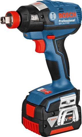

Bosch makes a 1/2" hybrid. Interesting concept but I believe it's a bit more bulky than some other wrenches and it hadn't received the best reviews last time I read up on it. I would love to see some of the other companies make their own version of this but maybe it's patent protected to some degree.
Most people on this board who've tried it say they'd rather use a square to hex adapter on a wrench than a hex to square adapter on a driver. I'm looking to pick up a Makita 1/2" wrench which would be used for all of my socket work and as a backup to my Makita impact driver.

Yeah I had the Bosch idh182(?) And it was nice, only the hood ring didn't retain sockets worth a damn. Seemed more geared toward construction trades where it would be awesome for doing the occasional anchors and tightening your floor plates.

I have the Bosch hybrid tool and I love it. It does screwing duties or wrenching duties. It has about 140ft-lbs available with the 1/2” chuck.
I still own a pneumatic ratchet and impact for when the needs arise. If I only could have one tool though, it would be the Bosch.
