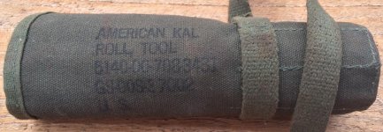

I can add images of my American KAL roll to the mix here. All the wrenches are marked KAL except for the odd man out, a Proto.
