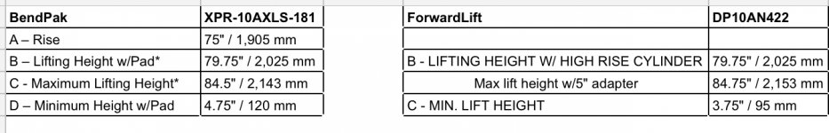

Here is a quick comparison. I had a tech spec sheet that the installer provided me that was not on the ForwardLift website.
Honestly I think the ForwardLift is shaping up nicely. It has the added benefit of their 3 spot arm feature allowing for a symmetric and asymmetric setup and at a slightly lower price than the BendPak.

i didnt see any spec for the overall height of the forwardlift? if less than the bendpak 157" then the added lift height does nothing for lifting an suv since it will touch the top if its a standard height.
Not sure where you got 157” from.
The BendPak model I’m looking at has a floor to switch height of 176”. The ForwardLift shows a floor to switch height of 160.75”. So the BendPak does have more room.
forgot you mentioned the -181" version, yea you are correct.
