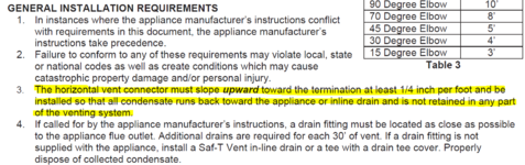

It's currently sloped up ≈1/4" per foot following the install instructions. Read a lot about the up vs down slope and there was no real consensus, some ran them down while others ran them up. I chose up mainly because that's how it's shown in the instructions, from my reading the short runs like mine the flu gas should remain hot enough to not condense. I'll keep an eye on it this winter and see how it goes.
I will guarantee the flue gas will condense, at least on start up and in cold weather. That is why stainless steel is required.

Mine angles down and I’m always surprised how much moisture comes out of the vent. In the winter it freezes on the ground and there will be a mound of ice there after a month.
I definitely recommend angling down.

Interestingly enough BOTH the Mr. Heater install manual and the Saf-T vent manual agree on the 1/4 per foot minimum upward slow toward the termination.
The Mr. Heater manual shows a condensate drain only for commercial installation but not residential and doesn't give a reason that I can find. It does say the drain must be within 5 feet of the appliance, so runs less than 5 feet it may not be an concern? :dunno:
It's currently installed with an upward slope to the termination and I'm planning to run it that way. I'll keep an eye out for condensation and can add a drain easily enough. Menard's has them in stock.
