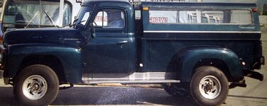

I have had great success using DC4 as an assembly grease on disc brakes. I only use DOT 5 brake fluid.
On one of my trucks the brake line to the rear burst. The inside of the tube was in perfect condition, but, the outside of the tube was corroded. I drove that Truck for 20 years and almost a quarter of a million miles.
