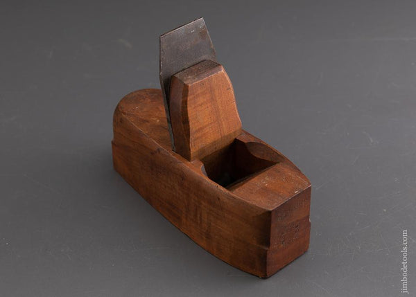

Yup, I’d call them all scrapers, with the blades properly prepped, and set close the the cutting face, the will do a wonderful job of removing wood, lightly. These are not tools for hogging of wood but rather to fair a curve, match surfaces, get a great finish on figured wood,
13,494
Toothing planes... something new in my vocabulary.
Yup, a sort of forgotten tool. Most vintage ones are wooden, with the blade set close to vertical, and a coarse and fine toothing blade being offered, two different TPI.
One of mine is similar to this
Now, you can get a toothing blade for a low angle plane, which I’ve not tried yet.

You do realize the "serrated" edge of that blade is the non working edge - correct?
Mystery is exactly the word I would use, but then again, way way back when rocks were still soft, people were pretty ingenious.
I don't know if it was in here or something I read; however, that serrated edge could/would/might have been used to prep a surface for a veneer adhesive. What do I know? Not much. Only a guess.
Look up toothing planes & blades.
I really don't think that is a toothing plane. Toothing plane blades are grooved in the back so sharpening the bevel makes a lot of very small points. I think my WAG above is correct. It is a handmade scraper version of this. https://www.leevalley.com/en-us/sho...35i3Yd7BS5LC5aPB3ZRXcYtdUyS3EqDQaAnodEALw_wcB
I couldn't remember what they were called, but a little googling says "chair devil" or chairmaker's devil" Here is a modern made version someone did a nice job on. https://ralstonfurniture.com/tools.html
