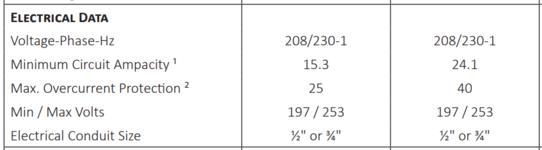

250v is close to the upper limit. I wouldn't go out and buy a b-b xfmr b/c of that.
Here is a snip-it from a condenser unit spec:
If I had a b-b xfmr sitting around, I might install it - but not my 1st priority. You would also need it sized (KVA rating) for the load.
A downside to having a b-b installed is, if the voltage sags in your area, then the b-b could compound that problem.
I have seen the voltage at my house as high as 254V and I'm running the same condenser for years.

The spec on the unit is the same as any other, 208/230. Most all bb are either 12/24 or 16/32, and dropping 16 would get me the closest to 230.

What is the upper limit if the units operating range? 208/230 doesn't really tell us anything especially since 230v isn't a thing in single phase service in the US

The service manual says 253. I have observed the incoming voltage getting that high a couple times before.
