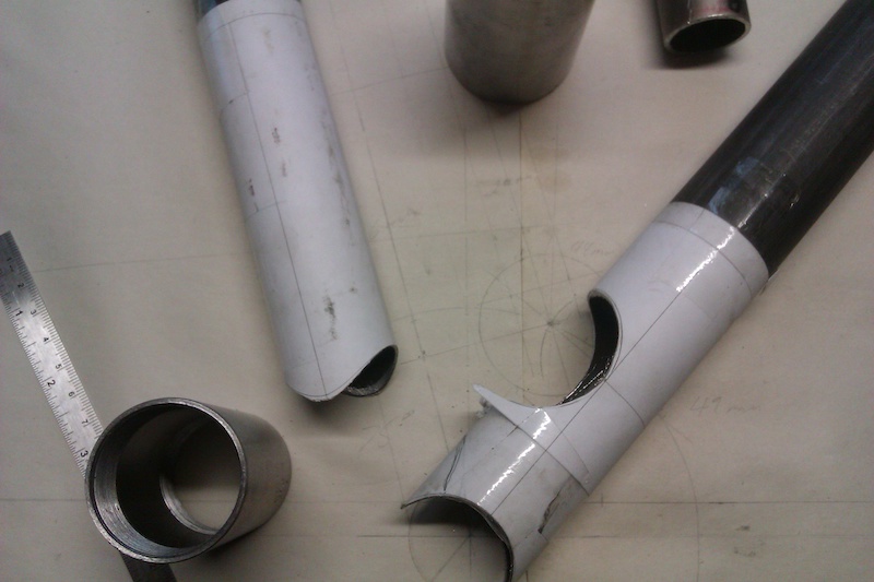

First bike is a tubeset from
Cycles Nova..
It's 4130 bike specific butted tubing. I braze with an oxy/propane set-up. My oxy if via an oxygen concentrator (used medical unit). Torch is a little Uniwled 71 running specific tips for the propane (TEN tips).
This thread on Vsalon has great info on oxy/propane.
I used methods outlined in the Paterek manual to keep things true and aligned. Biggest thing is to cut accurate mitres. There is lots of reading to be done online, for your first few frames don't worry too much about how well aligned or accurate the final assembly is. A mm or two here and there will not have a drastic affect on how the bike rides.
A surface plate (old granite countertop is accurate enough) and V-blocks are way more valuable than bike specific jigging.
