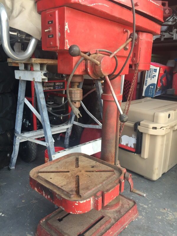

Any ideas on what DP this is?
bawb
Apr 7, 2016
21
Phoenix
I saw the slow speed pulleys and the table lower/raise crank and had to get it.
Someone painted over all identifying labels so the first step is figuring out what I bought. Also the chuck goes up to 3/4".

looks like an early metal working DP from Taiwan machine to me. note shape of motor, the locking collar for the depth stop, the way the gear is clamped to the tube, the bolts on the base, etc. only thing that doesn't jive is the smooth casting. maybe someone bondo'd it before painting.

It looks very close to the Craftsman drill press I bought in the early 1990s

I agree it's a taiwanese machine. The depth stop collar is what tells me. Most American DPs use a rod with knurled knobs.
I bought my Craftsman DP used, but it probably dates to the 90's.
Yeah, mine's got the same exact table (and rack), motor mount/adjustment and pulley setup. I couldn't say this is Craftsman or not, but it sure came out of the same factory.
Whoever replaced the switch did you a disservice. The should be a second switch for a worklight that's hidden in the casting behind the quill.
Sent from my D6708 using Tapatalk
Correct. The nice thing about the collar is you can spin it all the way around and use it as a height stop too to keep the quill down a bit for repetitive operations where you won't want to raise the table.

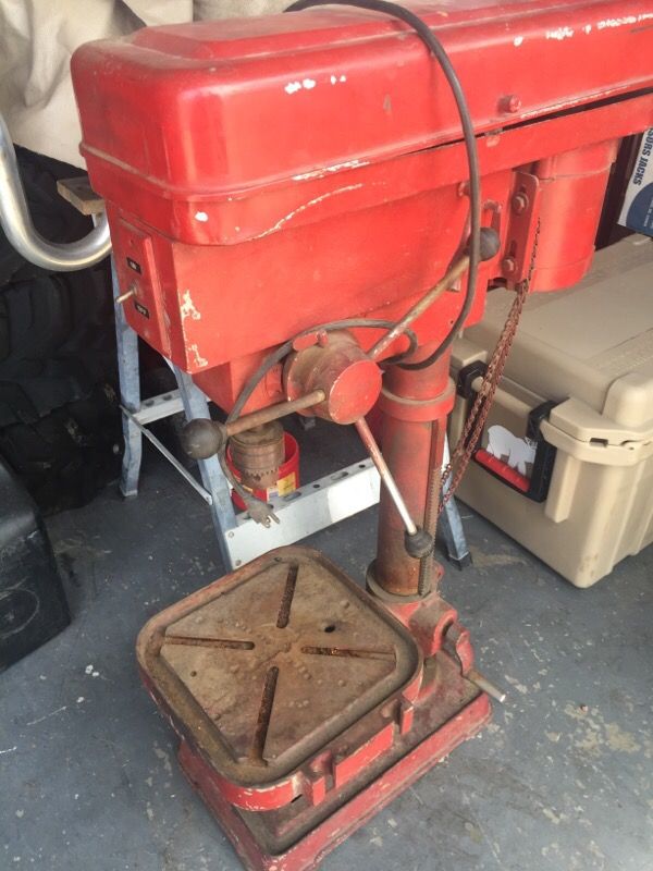

It does look like a layer of bondo on the bottom, then a silver/gray color with the red on top.

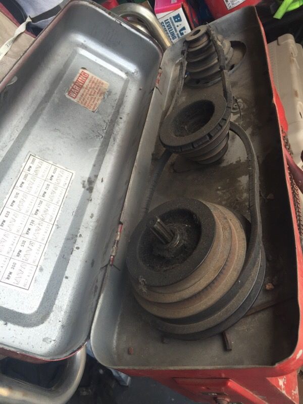

Thanks rlitman. I did notice the light bulb hidden up inside there when I was unloading it but was dissappointed when it didn't light up. That was a good part of my motivation of tearing it apart to get inside and see what was wrong. They had it wired to come on when the press was turned on, so I may keep it that way instead of adding another switch. But if I can't find the same socket, I may just use a pull chain socket after all.

Pic 2 Put the new light bulb socket in here.
Pic 3 It does look like someone used bondo. You can see some in the crack on the collar.
