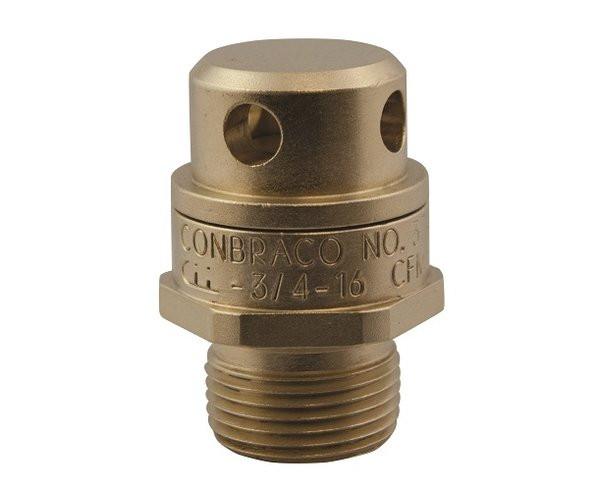

Installing a heat pump/hybrid WH in my shop, using a combination of Pex and copper. I came across a video showing a very clean installation and am looking to replicate it. The only piece I'm not sure of is circled in the attached photo. Is it a back-flow preventer? Not sure why it is installed where it is (cold inlet line). Is it needed? I already have a back-flow preventer on my incoming water line from the city.

I would say it's a vacuum break /backflow preventer. probably a local code thing so water can't be sucked back from the heater in a vacumm situation on the supply
Great, thx. As long as I have a backflow preventer on the incoming line, a second one at the WH would be redundant, yes?
I've never seen one installed like this, but I agree that there's nothing else that looks like that, though if it were a vacuum breaker, it's missing it's bell top (which is an important part of the system). Anyway, a vacuum breaker must be installed at least 6" higher than the highest point plumbed downstream of it. As it is, it's higher than the tank (good), but the red hot water pipe goes up from there, so this vacuum breaker does absolutely nothing [useful]. Had the water heater been in an attic with everything below it, then a vacuum breaker above it might make sense in some AHJ I suppose. In this orientation, you'd need an RPZ valve to fully protect the supply, and an RPZ should not be installed indoors. Also, a vacuum breaker itself probably shouldn't be installed indoors in a part of the system that stays pressurized. It's fine on a faucet, but used like it is here, it's a recipe for catastrophic flooding.
tl;dr: don't copy this picture. It's stupid.

This vacuum relief valve looks like the one in your picture.

The vacuum breaker you asked about is fine for the application and is not missing any parts.Back in the day that particular one would have been used on low pressure steam systems because it is rated for 250 degrees F. I would use a Watts N36 for a domestic hot water heater simply because they were the cheapest option.Both operate the same.
