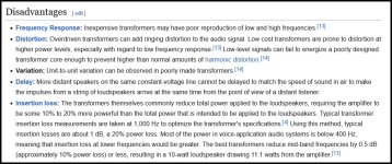

No, you don't want this for a house.
70V speaker output is designed for when you have large buildings with hundreds of feet of speaker wires.
If you get your hands on those amps, just wire the speakers in parallel on the regular output.
https://www.proacousticsusa.com/blo...multi-source-multi-zone-audio-control-systems
https://en.wikipedia.org/wiki/Constant-voltage_speaker_system
Not to keep jerking the OP back and fourth, but...
Most of the negative points in this wiki are referencing "Inexpensive" and "low-cost" transformers. QSC and JBL are not going to have these issues. I have installed plenty of 70v stuff, and it's come a long way since the old "School PA System" days. The last setup I did was a similar QSC amp and Atlas ceiling speakers in a 40' square meeting room, and it sounds great.
OP- If you buy the amp, just try it out on the bench. Hook up some speakers to the 70v side and see how it sounds. I'm sure it will sound just fine. I have been pleasantly surprised by modern 70v setups.
... But you are. :LOL:
Why would you want to install something with no benefits and some real potential downfall?
