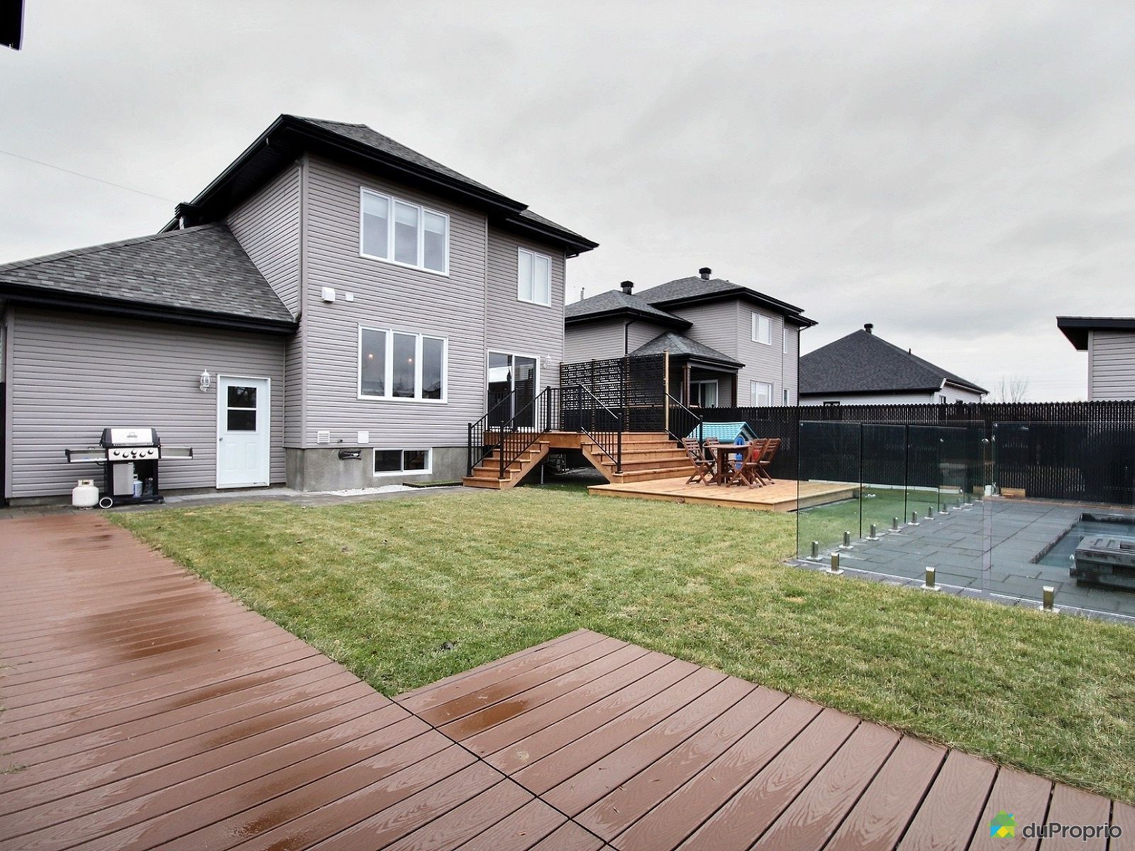

Before I start calling around for estimates, can someone give me an idea of the price increase % of using Trex (or similar type material) vs wood? After thinking about it, I really should just build a simple wooden deck, and add black aluminum spindles in the railings to dress it up some. Perhaps do what was pictured above and angle some of the boards with a "trim" board, and I can stain it myself with two different colors to give it effect. Then add lighting afterward myself.
It's kind of to the point where I'd like to have it structurally designed and put into the ground with the posts and joists, and I can do the rest in terms of the boards and railings. But I need to start somewhere first...
Trex (or any name brand composite decking like timbertech) depending on the line you buy will be 3-4 times the cost of regular PT wood.
Staining things different colours will be a nightmare in a few year when you have to re-do the stain, I wouldn't want to have to deal with keeping the colours separated. Even just doing the pattern can dress things up but there's a lot of extra labor and material waste involved in doing it.
Hiring out the posts is worth while but building the frame is simple. If you're not sure about the structure, get it designed for sure, but don't be shy to do the framing yourself.
