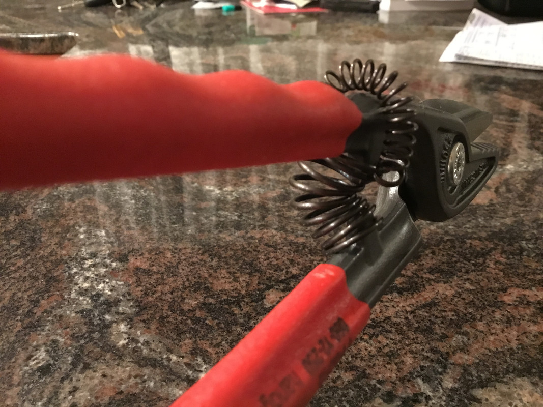

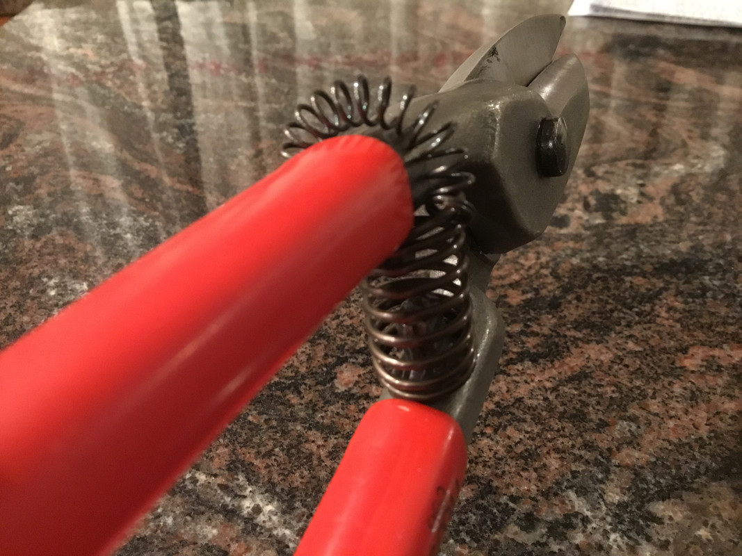

Just ****.. lol. Worth the wait.
Only thing NWS needs to do is make the perches or foundation where the spring meets the handles on the 250mm model a little bit wider. The thin handle kinda invites the spring to roll over to one side or the other and get a little jammed up while closing them. I adjusted the tension on the little retainer spring just a bit, and so far so good. That one little area should really have a wider, flatter surface just for spring to seat
To prevent this from happening
Compared to the others
