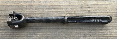

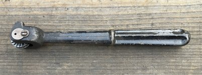

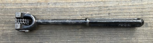

Anybody know what this tool is??

Have been going through my grandfathers tools and I came across a tool that I have no idea what it is?Has anyone ever seen this tool and if so do you know what it is called and what it is used for?IMG_0925.jpegIMG_0924.jpegIMG_0923.jpeg

-As posted above it's a very basic dressing tool for the bench grinder. The video suggests that it's good for maintaining sharp corners on the grinding wheel, it can/does. To me, it's far more important to use maintain the periphery surface/face of the wheel. Grinding wheels frequently get clogged from the material being ground, glazed from heat/friction, or just dull when the sharp corners of the abrasive particles have been rounded over. A visual inspection of the wheel while it's unplugged will reveal whether it needs dressing or not. If the "pores" in the wheel show bits of anything besides the wheel (hopefully not aluminum!!) then it needs dressing. If the wheel has a somewhat shiny/glazed appearance then it needs dressing. Dressing fractures the abrasive particles in the wheel to expose fresh sharp edges in what the wheel is made of, this allows faster/cooler grinding to occur. Dressing also removes the "furrows/grooves" in the wheel from the bad habit of holding an object in one place on the wheel while grinding. Dressing shouldn't require much more than about 5 seconds to do. If it takes longer than that your grinding technique needs to be improved. Light/medium pressure while dressing is enough. There's a lot of abrasive particles thrown off from dressing so wear a face mask, abrasive particles are VERY bad to breathe in. A light source will reveal how much **** goes airborne, ventilation/vacuum is advisable if available. Gloves are optional but keeps your hands clean, a paintbrush for the dust created is also good. If using vacuum be wary of sucking sparks in that creates a fire hazard.
-To @Ran58 it's a nice older dresser, the star wheels in yours are about in need of replacement so the dresser handle doesn't contact the grinding wheel (that will load up the grinding wheel with material from the casting). The star wheels are fairly cheap, a pack of 10 is under $20 and would last a lifetime, less than 10 is more than enough.

-As posted above it's a very basic dressing tool for the bench grinder. The video suggests that it's good for maintaining sharp corners on the grinding wheel, it can/does. To me, it's far more important to use maintain the periphery surface/face of the wheel. Grinding wheels frequently get clogged from the material being ground, glazed from heat/friction, or just dull when the sharp corners of the abrasive particles have been rounded over. A visual inspection of the wheel while it's off will reveal whether it needs dressing or not. If the "pores" in the wheel show bits of anything besides the wheel (hopefully not aluminum!!) then it needs dressing. If the wheel has a somewhat shiny/glazed appearance then it needs dressing. Dressing fractures the abrasive particles in the wheel to expose fresh sharp edges in what the wheel is made of, this allows faster/cooler grinding to occur. Dressing also removes the "furrows/grooves" in the wheel from the bad habit of holding an object in one place on the wheel while grinding. Dressing shouldn't require much more than about 5 seconds to do. If it takes longer than that your grinding technique needs to be improved. Light/medium pressure while dressing is enough. There's a lot of abrasive particles thrown off from dressing so wear a face mask, abrasive particles are VERY bad to breathe in. A light source will reveal how much **** goes airborne, ventilation/vacuum is advisable if available. Gloves are optional but keeps your hands clean, a paintbrush for the dust created is also good. If using vacuum be wary of sucking sparks in that creates a fire hazard.
Thank you. A wealth of knowledge on this site.
