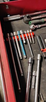

The magnets were one of my favorite things I did in my extension holders. They aren't strong magnets, I went with something just strong enough to keep the holder from moving through a drawer liner but not strong enough to hold filings on top of the extension holder.
I chose the magnets I used for a couple of reasons.
I didn't need a lot of strength so while I dropped some epoxy on the backside of the magnets they are a press fit.
The open cup collects filings and while my design case is the placing them on drawer liners I don't want a magnet that is hard to clean that may be placed on a painted surface.
Not that other magnets wouldn't work but they weren't appropriate for my application.

probably something like this or this
The first of the two or something like this:
Threaded stud not required.
The metal outside acts to direct the magnetic flux and sort of "complete the circuit". (Sorry, I tend to think electrical.) You'll notice the magnetic tool bars from Harbor Freight have a metal U channel around them and the pull is much weaker on the metal channel side. It pulls harder on the side where the tool or other metal object is required to complete the "circuit".

I printed some individual socket holders with magnets. Lets me shuffle the sockets as I add and remove. Also having a few extra lets me stick holders to my portable box or even the vehicle so I am less likely to have them drop. Need to play with the designs some though since they are a little weak in one size. Can't really used the cupped units mentioned above since I need them to hold both the socket and the surface below.
