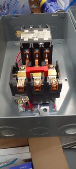

This controller was given to me by someone that said it should work for controlling my 5 HP frankenstein compressor I am eventually going to put together.
I don;t know much at all about magnetic controllers. Anyone that can guide me with this is much appreciated . I do think I have to change a thermal break to properly protect the motor . I guess I need to know where to connect the load, the motor and the pressure regulator ( if this can be used that way .
Thanks , ask any questions needed.

Does the cover have a diagram?
I can’t tell what voltage the coil needs, you probably can take the front plastic cover off and it will be stamped/molded/tagged somehow.
The 3 brass things near the bottom with “B45” , those are called heaters and you need to look up what amperage they pop at. When any of the heaters pop, the clear plastic switch underneath with red wires opens the circuit to the coil and the main power drops out. If they are rated too high or any value too low you will need different heaters. The red bar resets the heaters after they cool off.
Single phase 240v will use only two of the three contacts. Power enters at 1L1, 3L2,and/or 5L3.
The white plastic thing underneath with red wires may be the coil. Your pressure switch circuit will likely be wired in series to neutral and the unused tab.
The motor leads connect to T1,T2,and/or T3.

if I break one ( or both) of the red wires with a switch, does that open the contact? and then if the switch get closed, does the contactor re engage?

No, those reds put the overload relay contacts in series with the coil. If ol relay trips there won't be continuity between 1L1 and the coil.
You need to also put a pressure switch connected from "3L2" back to the other side of the coil terminal.
Either buy a pressure switch with an on-off lever or add an on/off selector switch.
That is the control circuit described above.
Next you have incoming power to the starter connecting to 1L1 and 3L2.
Your motor connects to T1 and T3.
You will need a jumper from T2 up to 5L3.
You will also need to buy 3 overload heaters based on the motor FLAs. There should be a chart helping you to determine what size heaters needed.

The control circuit starts at 1L1 , then existing red wire to the T1 heater clear plastic block contact, then other existing red wire back to the white coil block.
Downstream side of the coil is the unused spade connection. That will eventually end up at neutral for a 120v coil or 3L2 for an 240v coil after going through the pressure switch contacts.
Found this diagram on here someplace and don’t know who made it.IMG_0276.jpeg
This particular contactor needed the power to go through all three contacts to be happy, otherwise the motor T leads would just go to T1 and T2 without going through T3.

thanks, I think I get it . I guess my only questions ( right now) does T2 have to jump to L3 or can T2 go directly to the motor , and use L3 & T3 to run a 120volt hour meter?
and the wire to the pressure switch need to be #10 , or do I fuse it or?

The last time I amp checked a coil it was one amp, so fusing it for 5 can’t hurt. I usually see #14 control wires even in 4160 cabinets.
If the contactor doesn’t need load balancing, you absolutely can use two contacts for the motor and the third for anything else. Might want a different heater or even a blank heater, depending upon the load.

The overloads won't function properly (generate proper amount of heat) if only 2 of the 3 are used. This can cause the motor damage if overloaded and starter not trip soon enough.

There is a little bar that mates with the pawl on the heater, it has to be held back or the overload relay will not reset, that is one of the quirks of SQ D.

NOPE! the jumper kit is needed to do the job properly when using a 3Ø overload relay in a single phase application, still cheaper then using 2 heaters & leaving one of the existing heaters in the center pole.

What I meant was 2 existing heaters of a larger (wrong size) will be in-place instead of the plates you linked to. They would physically keep the o/l contacts from opening as the ratchet is restrained.
Additionally, a 3rd heater (properly sized) and installed in 1 of the 2 poles completing the motor circuit provides the protection.

The way the heater selection is shown in the table, your options appear to be:
  • use 1 heater and and 2 jumper plates. Heater selected using single phase column
or
  • use 3 heaters properly sized and motor current needs to run through all 3 heaters (jumper wire from motor side term back to line side term)
The difference between the single phase and three phase motor currents for the same heater size relates back the the overall heating effect the overload relay housing experiences.
