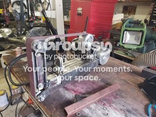

Chapter 2! Well here's the proto type. Pretty happy with it, would like to change the frame a little bit, more of a cosmetic thing really. Also the over centre belt tightening gismo I spent to much time building this and afterwards I remembered I have some desta clamps that would work just as well and look better. Another issue is I trying to find a source for a 10" serrated contact wheel at a reasonable cost without paying to much shipping. I made my own with this one and made a hell of a mess in the shop grinding rubber. There's a seller on eBay but the shipping is 659$ or something like that. I'm sure it's a mistake but haven't heard back from him to see what the actual shipping cost is. BCD
