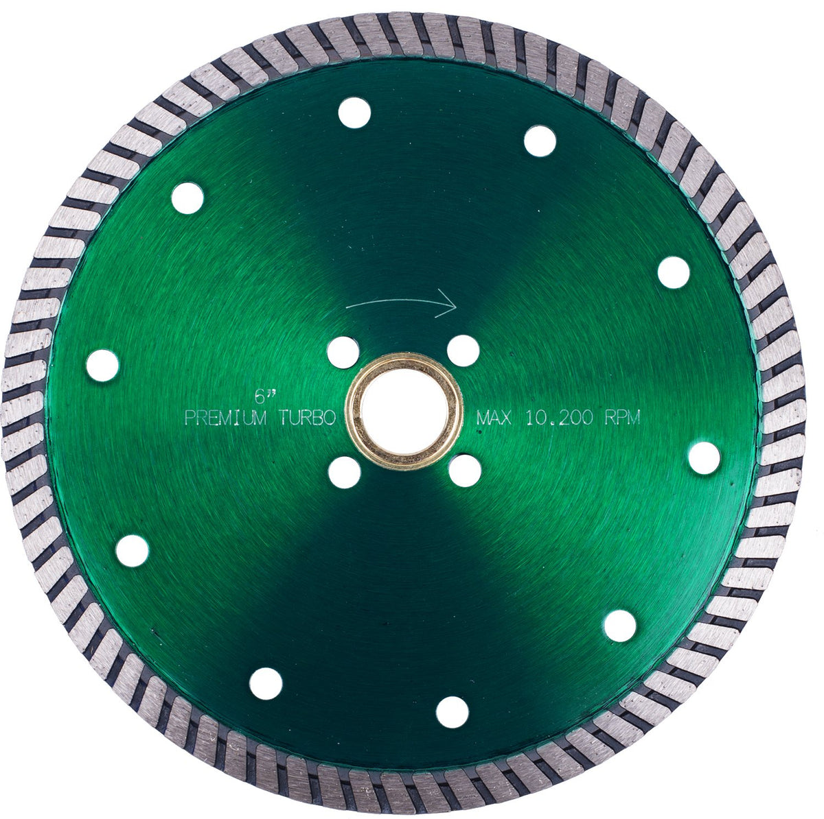

They have specific blade design for granite / marbles / tiles etc like butter, but a bit pricey. last I check It was about $40 each.
something like this but it will specific spell out granite, I don't remember the exact brand I have but those are not name brand from box stores, just what those people uses.
